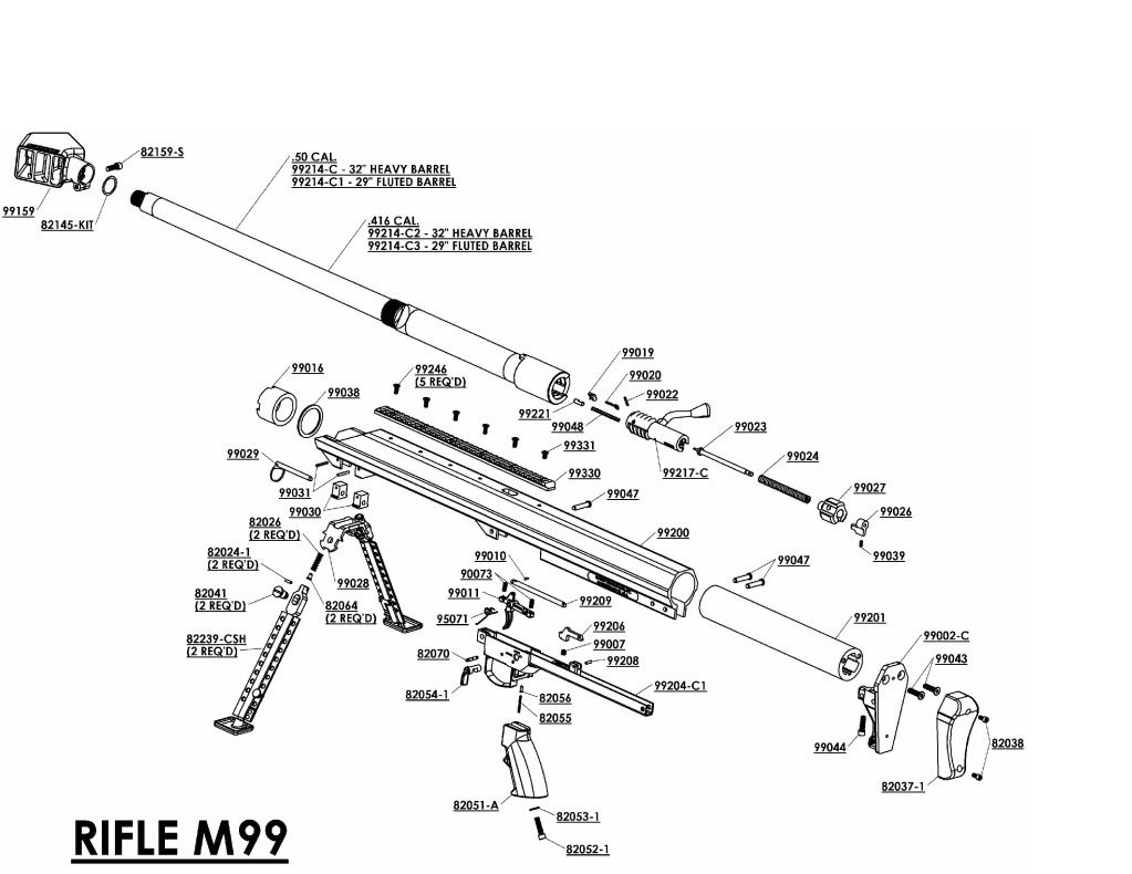

Seems like the other 99s NEVER had them.... I checked my old manual and it seems as though the ONLY M99 with the sling attachment points was the M99H (Hunter model w/25" fluted barrrel). That kinda sucks, I guess. I just assumed all the M99s had the two sling attachment points.
But, by looking at both schematics, it would seem that the M99H rear butt plate insert (part # 99304); along with the 2 M99H longer screws (part # 99338 to replace the screws, part # 82038) could be ordered to provide the "rear" sling attachment point. Then one could drill and tap a hole in the front part of the rifle (part # 99200) and screw in a quick release attachment point for the "front" sling attachment point.
That would seem to be a fix for the other M99s, but before ordering the parts, etc., I'd give Barrett a call to be sure the screw pitch is the same for the two different screw sets (mentioned above).
I do know my sling is really handy for lugging the rifle around. Maybe other M99 owners have affixed slings using other solutions, that are simplier or more elegant. :det:
Here are the different schematics for both M99 configurations. I'd guess the M99 one still matches what is currently being produce...
